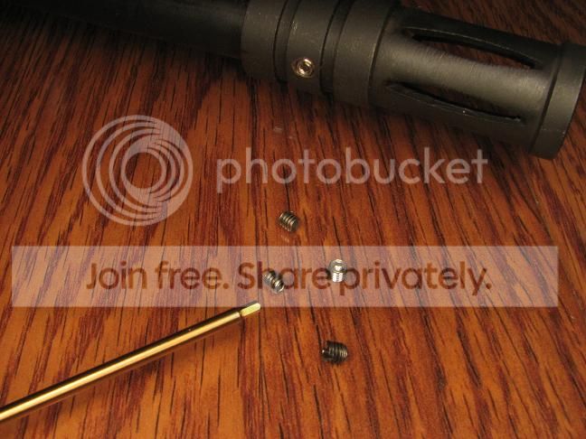

Hey guys last weekend i went to my locak "HobbyTown USA" took in my flash hider muzzle brake thing and they found me a steel grub screw that fits my e-bay 10/22 flash hider/muzzle brake.
Mine stripped the first time i put it on (black one) i cut a slot in it and ive been using it that way since i got it but i decided to get a replacement. Hobbytown has alot of little screws and parts for R/C cars and most are pretty good quality little parts. They use titanium and good quality steel and aluminum parts. I wasnt sure if they would have one that would fit and be the same threads and everything but they did. $.10 cents each.
I picked up 4 so i have 3 extras if anyone needs one fire me a PM with an address ill tape one to some paper and shove it into an evelope and drop it in the mail box for ya. I figured at 10 cents ide get a couple extras fo anyone else that stripped theirs out.
I believe the tool im using to tighten them is a 2.5mm and the screw is a 3mm? not for sure though.

You may or may not know this but if you can drill a small indentation into the barrel where the set screw rests it will stay much more secure. I had to do this with my 10/22 as it would keep working loose.

Yeah i did that. The first time i took it out it was loose when i got home but it didnt fall out. Then i drilled a little bit into the barrel and it then fit more flush down inside there. It still backs out now and then but its better.
After i cut the barrel i redrilled it and did the same thing but i took better time where i placed it and how far down on the muzzle i mounted it. Im about ready to lock tight it on now. Ive got the crown and everything looking and working good so now it wont need to come off as much as it did before.
