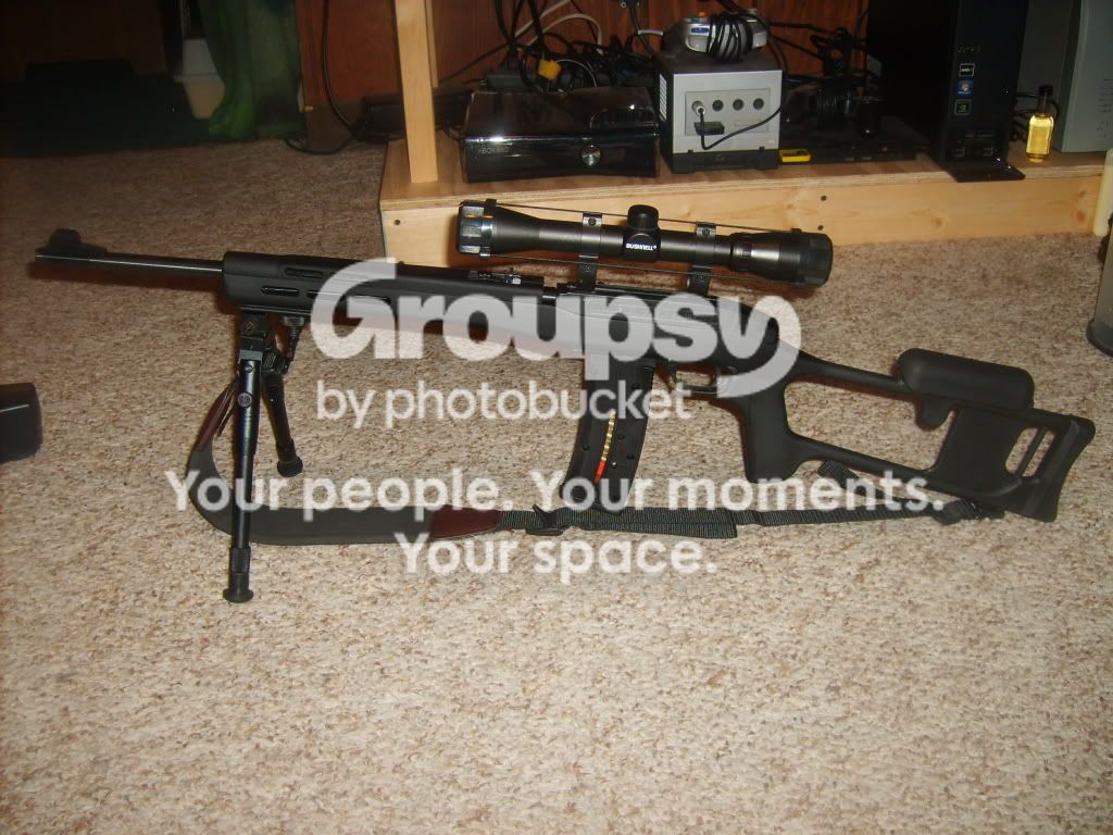

    Ok. I'm new here and I had to post a picture of my 702. I looked for entirely too long trying to find a picture of a plinkster with a 25 round mag installed. So if somebody wants to see it I posted it.
    ATI Marlin stock (MAR3000), ATI universal cheek rest, $7 Winchester sling I figured why not it's only 7 bucks. Cheap but decent stud mount bipod had to use a spring pin instead of the screw that came with it. Base was loose and rattling trimmed the pin to length and it's solid as can be. Leupold see-through rings with bushnell 4 power.
    The stock is by far the most time consuming and annoying thing to modify. It still doesn't fit the greatest but it's tight. A good dremel kit does the job. Feel free to call it a hack job because it is!
    Anyways to sum up : gun 117, scope 30, rings 8, stock 38, cheek rest 10, sling 7, bipod 28, 25 round mag 30, 2 extra 10 round mags 30. About 30 dollars shipping total.
    Grand Total : $328 roughly. Sounds like a lot for a plinkster but it was well worth it! You can hit 20 ounce bottle caps between 30-40 yards all day long with it. My favorite ammo - CCI standard velocity RLN 1070 FPS. I still haven't shot it with the 25 round mag. I can hardly wait.
