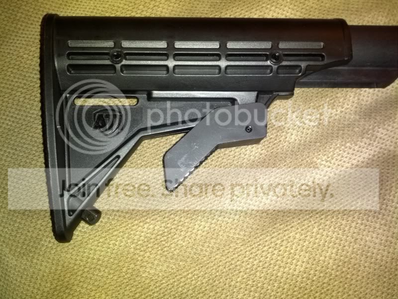

Hmm, my flat top stock doesn't look like that. It seems that the pin is contained under the adjustment lever. It seems that I would have to remove the adjustment lever to pull that pin down.

Can you post a pic?
I'm trying but for some reason the upload from my phone to Photobucket is taking forever. However, it appears the lever that allows movement is actually mounted to the pin you are referring to, so I decided to just pull straight down and hard on the lever that allows the stock to move. This pulled down the pin and allowed the stock to come off. If the picture ever uploads I will post it just case it can help anybody in the future.
Here's the pic.... you see the small pin in the lever. That is the pivot point but is also the attachment point for the pin that is pulled to allow movement. I just pulled on the whole handle to remove the entirie asumbly.
how dose that pin come out that the lever pivots on , just a punch and hammer ? or dose it snap over the pin, and the pin for sling just unscrews right , i wanna paint the gun but doing it right the first time
If I remember correctly the a punch and hammer will do the trick on the stck adjustment pin.
...and yes, you can simply unscrew the sling swivel stud...
