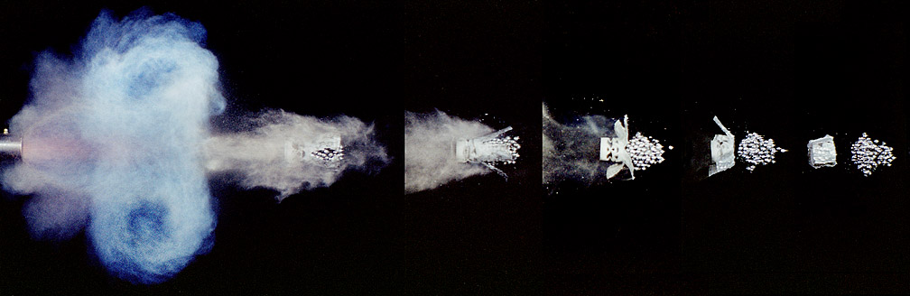

Here's a shot sequence that shows how the shot cluster develops after leaving the barrel. This is a 12 gauge shell using a shotcup, and pics are a series of individual 1/1,000,000 second exposures showing shotgun firing shot & wad/cup separation. Distance covered is about 6 ft.
There's stuff in here I've not seen before, some pretty cool stuff in fact, thanks!
