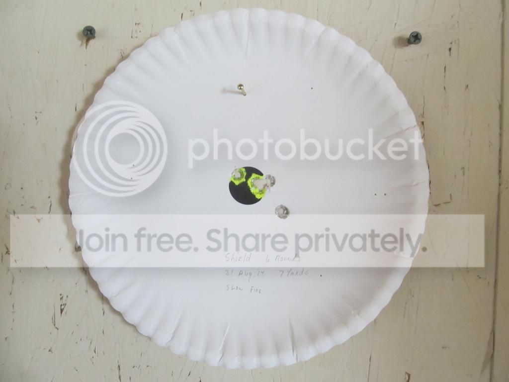

Working on a new tighter grip for faster follow up shots for competition. Trying to decrease muzzle flip.

Then get faster a tad as you find out how short of an interval will still allow you to keep your groups, not really tight, but with in an area that you'd need for self-defense applications. Say the 8" diameter down zero zone on an IDPA target. Paper plates are good. After you get your short distances down, increase the challenge by backing off bit by bit to 15 yds. Make mental notes about how fast you can shoot and keep the holes close enough together.
