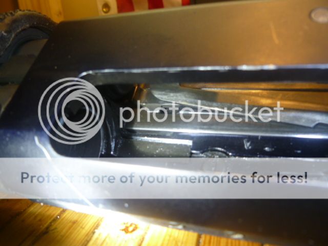

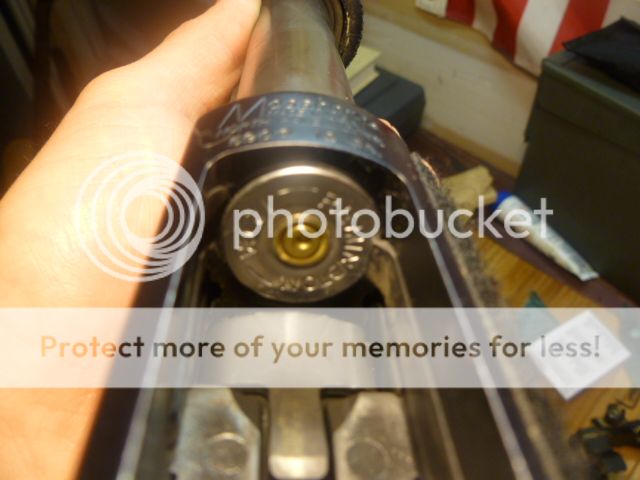

aksavanaman said:
This shows the Cartridge Stop on the right side of the receiver in action.

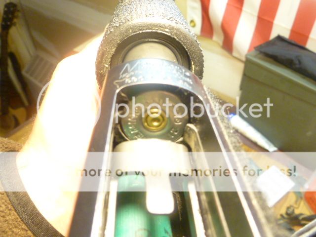

This picture shows the interrupter (on the left) in action. The interrupter keeps the shells in the mag tube as the lifter chambers a shell.
This picture shows the right action bar as it's actuating the cartridge stop. Notice how the cartridge stop is starting to ride behind the action bar... a common problem occurs when this stop rides in front of the bar causing a bind...
And then there's the bent cartridge stop lever that doesn't quite move far enough to allow the shells to enter the chamber....
I am going to have to replace both the cartridge stop and the Cartridge Interceptor Assembly in my 500A.
It has started to cause an intermittent failure to feed and I cannot have that.
